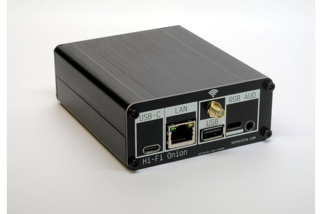

What is it? The Onion Omega Home Media Center is a compact and neatly designed hardware project that combines the power of the Onion Omega board and the Hi-Fi audio capabilities of the TI’s PCM5100 3…
Read More…The Onion Omega Home Media Center is a compact and neatly designed hardware project that combines the power of the Onion Omega board and the Hi-Fi audio capabilities of the TI’s PCM5100 32-bit DAC. This versatile media center provides a customizable and fully open-source hardware platform for home entertainment.
With a minimalistic but functional design inspired by commercial audio gear, it offers a seamless user experience. It aims to support Airplay, Spotify Connect, LMS, Snapclient and other lightweight protocols that can be integrated into Home Assistant, or any custom use case you may come up with.
I did few audio projects in the past, some using ESP32, some using larger Orange Pi and Raspberry Pi devices. Each has its pros and cons, and each iteration I'm trying to focus on the details that were working best for me, while actually using them.
Onion is not a powerhouse compared to the Raspberry, but it is much easier to work with, compared to the ESP platform. It has both Ethernet and WiFi onboard (which both Raspberry Pi Zero and Orange Pi One don’t), also it doesn’t rely on the SD card, which makes it indestructible in the long run.
I think Onion Omega is a fun platform to tinker with (although slightly forgotten these days), with a lot of potential yet to be discovered and developed.
Onion Omega HiFi is a first-in-line product that uses the legendary PCM5100 series DAC with supreme audio quality. It exposes line-level output that you can plug into a stereo amplifier. Spend as much as you need on the external amp to deliver the sound you like (personally I prefer late 80's audio gear).
