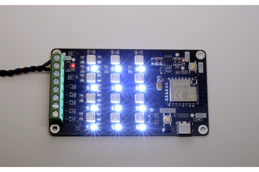

ESP Luma Drive is a simple device that is designed to be used as an ESPHome-controlled Home Assistant integrated smart lights controller. It has an onboard LED matrix consisting of 5 colors (RGBW + n…
Read More…ESP Luma Drive is a simple device that is designed to be used as an ESPHome-controlled Home Assistant integrated smart lights controller. It has an onboard LED matrix consisting of 5 colors (RGBW + night yellow) and a set of MOSFET drivers to individually control 5 lines of external LED strips (RGBWW), so it can be used with either.
I'm a Home Assistant enthusiast and working to automate my routines around the house, including a bunch of sensors and lights. I had an idea to include existing ceiling LED strips into the Home Assistant setup a long time ago, so I did.
The main component of the board is an ESP32-C3 MCU, that is powered from the same source that is powering the LED strip. That is usually 12V, too much for a linear regulator, so I used a high-efficiency drop-down converter instead. For ease of programming, I added a USB-C port, so whenever it is connected, it will be used to power the MCU, when 12V is missing. Although 5V is not enough to power onboard LEDs, it is convenient enough to program the MCU when needed. Why 5V is not enough to power LEDs? More on that below.
When I did the external LED controller, I thought that the LED strip was a great use case, but the device itself can be a glowing star of the show itself since I have no reason to not place a bunch of LEDs on it directly. This can be used to replace some of the smaller size lights around the house, with a specific use case for running runway lights on your night trip to the toilet and back from it.

Internal LEDs | 5 channels, 12 LEDs each: RGBW + Yellow |
External LED drivers | 5 channels, 4A each: RGBWW (suggested) |
Wireless Connectivity | Onboard WiFi + BLE |
