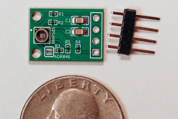

What is it? This is a small (0.7 x 0.4 inch) breakout board for PixArt's PMW3901MB optical flow sensor. This is the same optical flow sensor used in Bitcraze's Flow Deck but here in a much smaller fo…
Read More…This is a small (0.7 x 0.4 inch) breakout board for PixArt's PMW3901MB optical flow sensor. This is the same optical flow sensor used in Bitcraze's Flow Deck but here in a much smaller form factor for easier integration into your robot or UAV project.
The PMW3901 optical flow sensor is just like the tracking sensor in a typical mouse but here designed for ranges from 80 mm minimum to infinity. The sensor requires a lens (provided with the breakout) that enables the far-field tracking capability. Practically, we have tested the sensor with good results at table-to-ceiling (6 feet) distances, but outdoors the range could be quite a bit longer. The field of view is a rather wide 42 degrees.
The board is designed to mount directly onto the non-USB end of a Teensy 3.2 or a Butterfly or Dragonfly development board for easy prototyping and testing. It can also be used on a breadboard. The board exposes 3V3 and GND, the SPI port for serial communication with the host as well as the sensor 1.8 V enable (active HIGH, pulled up by a 10 K resistor), and a motion detection pin (active LOW) which is some kind of an interrupt but the datasheet has no information about how this is supposed to be used (see here for an example of interrupt-based data collection). The reset (active LOW, pulled up by a 10 K resistor) is also exposed on the board.
The sensor requires 1.8 V VDD power input and this is provided by a low-noise NCP161AMX180 LDO on the board. The input power to the board is 3V3 and the SPI (VDDIO) port is 3V3 so the sensor will work with any 3V3 microcontroller. Use a logic level translator if using a 5 V MCU like an Arduino UNO. Even though the RC filter circuit is optional I have included it here on this board for best performance. The low-noise LDO and the RC filter circuit make possible the superb accuracy we have seen with this optical flow sensor.
