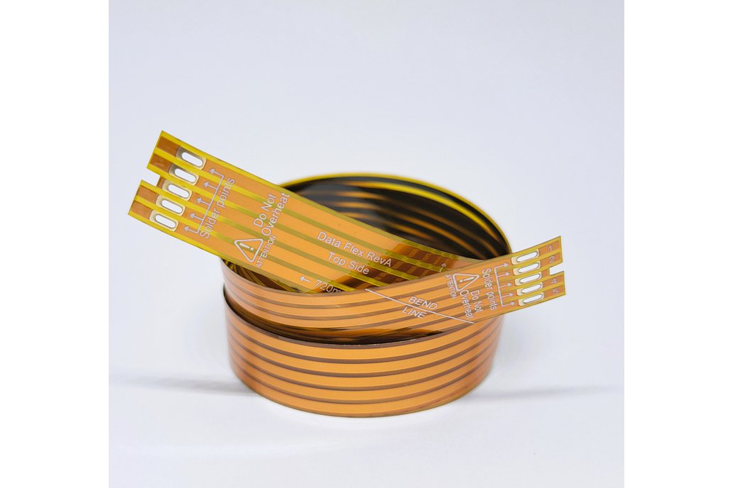

Compatible with Volvo S60, V70, XC70, and S80 P2 models up to 2004 (vehicles without DSTC).
If you’re seeing an airbag warning light or your steering wheel buttons have stopped working, there’s a high chance the flex cables inside the clockspring have broken.
Your options are usually:
Buy a brand-new clockspring for several hundred dollars,
Gamble on a used unit that may fail at any time,
Or repair your existing slip ring with brand-new replacement flex cables.
This kit includes two high-quality flex cables designed specifically for the Volvo 8622185 clockspring, allowing you to restore full functionality without replacing the entire assembly.
