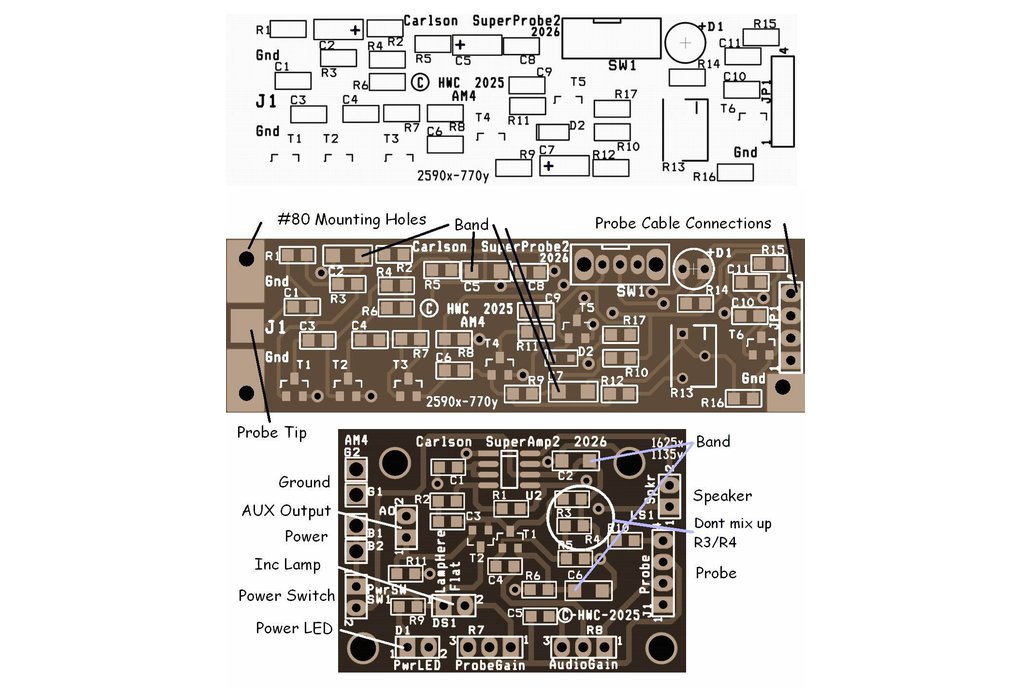

New and Improved Amplifier & Probe PCBs. Amp PCB Through-hole pads for all connections to PCB Uniform horizontal orientation of SMDs for easier assembly PCB mounted incandescent protection lamp for P…
Read More…New and Improved Amplifier & Probe PCBs. Amp PCB
PCB mounted incandescent protection lamp for POT R7
NEW optional buffer transistor for auxiliary audio output signal
Dedicated PCB connections for LED, switch, lamp, speaker, audio, POTs, power, ground
Probe PCB
Through-hole pads for cable connections to PCB
Ground plane
Mounting holes
Improved Pop LED driver circuit

Here is a great UT video of Carlson using the SuperProbe to locate a noisy component inside a complex transceiver. He makes it seem so easy, and with the SuperProbe it is! https://www.youtube.com/watch?v=uiK1BD7HILo The PCBs This kit includes only the main PCBs with NO PARTS. There are many components needed to construct a complete probe and amplifier. While there are a few through-hole & panel mounted components, all of the remaining parts are 0805/1206/SOT23 SMD parts. Soldering such components requires specific equipment, soldering tools, solder, tweezers, optics, skill and patience. We will provide the same instructions that come with our complete parts kit, but you are responsible for sourcing everything. Schematic details are included and are identical to the original design. You have the option to construct the PCBs exactly as Carlson specified, or implement the improvements we discuss in the instructions. These PCBs REQUIRE ASSEMBLY. The Assembly While there are a few through-hole & panel mounted components, all of the remaining parts are 0805/1206/SOT23 SMD parts. Soldering such components requires specific equipment, soldering tools, solder, tweezers, optics, skill and patience. Follow the included instructions in detail. Schematic details are included and are identical to the original design.
Some of the listing photos show a particular implementation in a very compact package. Such compactness is not necessary, but demonstrates what can be achieved. Photos may include components not on the bill-of-material, and are included as suggestions for completing the probe. See Our Battery-Pack and Case-Kit Options Too Check our listing for a Li-Ion battery pack & charger module. eBay #166266862893 https://www.ebay.com/itm/166266862893
