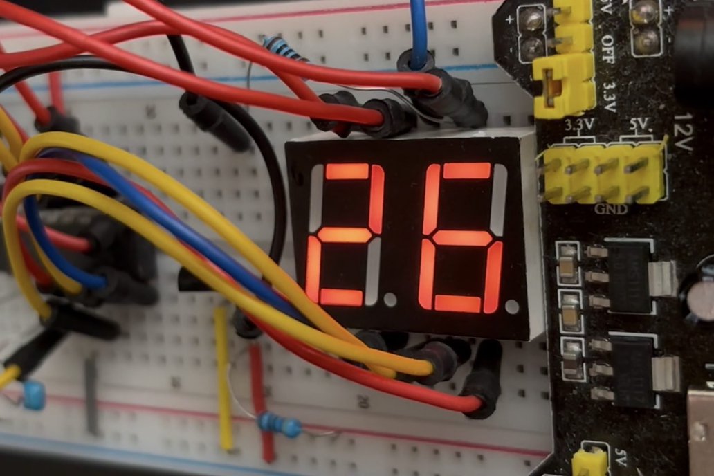

This is a digital download for the code needed to build a 2 digit digital thermistor/thermometer using the PIC16F628 and a DS18B20
Designed by DigitBox in United Kingdom
Demo here: https://www.youtube.com/watch?v=1vhxyDxPzY0 🔥 PIC16F628 Digital Thermometer Firmware + Full Build Package (DS18B20, Assembly Language) Build a reliable, accurate, and ultra-fast digital th…
Read More…Demo here: https://www.youtube.com/watch?v=1vhxyDxPzY0
Build a reliable, accurate, and ultra-fast digital thermometer using the classic PIC16F628 microcontroller and the DS18B20 1-Wire temperature sensor. This package includes fully tested assembly code, schematics, BOM, and everything you need to drop straight into your own project.
This is not generic code from the internet — it’s a fully optimised, timing-accurate firmware designed specifically for 4 MHz clock, correct 1-Wire timings, and stable operation even on long sensor cables.
✅ What’s Included
You will receive a complete project pack containing:
📌 Firmware • Fully commented PIC16F628 Assembly (ASM) source code • Pre-compiled working HEX file (ready to flash) • Celsius readings • Accurate 1-Wire timing routines
📌 Hardware • Full schematic • Bill of Materials (easy-to-source components) • Wiring diagram / pinout reference • Optional: PCB layout preview (if you want, I can generate Gerbers too) • All found here for free: https://tinyurl.com/Digital-thermistor
📌 Documentation • Step-by-step build instructions • How to correctly wire and test the DS18B20 • All found for free here also: https://tinyurl.com/Digital-thermistor ⸻
