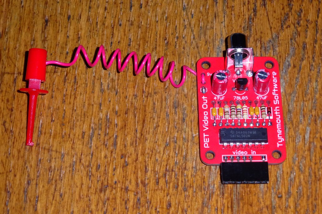

What is it? This is board which plugs into the monitor connector of a PET board and provides a composite video signal for bench testing. It is now available in kit or assembled versions. Why did you …
Read More…This is board which plugs into the monitor connector of a PET board and provides a composite video signal for bench testing. It is now available in kit or assembled versions.
When bench testing, it can be more convenient to use a composite video monitor rather than the internal monitor of the Commodore PET.
This is an updated version of the design which includes a delay to the horizontal sync pulse to correctly center the text in the display (the traditional circuits had the display shifted to the right).
This will only work with PET 2001/2001N/30xx and 9" 40xx machines. It will not work on anything with a 6545 CRTC, as that will generate signals that do not match the timing required by most composite video monitors (although it is possible using a modified editor ROM, but that is left as an exercise for the reader).
The signal generated is NTSC. Not all modern monitors will cope with a composite signal that is missing a colour burst, although most do. Likewise many modern TVs and monitors will support NTSC composite, even in PAL regions.
The board is powered by clipping it to a 9V source, the polarity protection diode is normally a good option, see photos.
