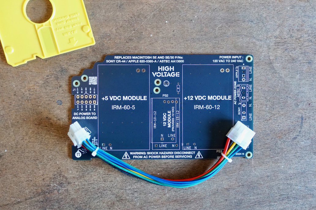

DIY Power Supply Board This custom-designed PCB lets you build your very own Apple Macintosh SE/30 or SE AC-DC power supply using all-new, modern components. Back in black. Key Features: Compatible …
Read More…This custom-designed PCB lets you build your very own Apple Macintosh SE/30 or SE AC-DC power supply using all-new, modern components. Back in black.
The design has been bench tested using an SE/30 outfitted with a PDS 68040 accelerator and Ethernet board and SCSI emulator board. During A/B testing this design has been observed to have less CRT image ripple over a Flex ATX PSU commonly used for PSU modernizations.
New for version 0.6: A footprint was added for an auxiliary 2x2 Molex connector (or soldered connection) to allow for direct connection of 5 VDC to the logic board connector. When a large 5 VDC load is run through the analog board and stock wire harness, the voltage may drop to a level that causes instability or issues with booting. An example machine configuration for a large load would be a heavily upgraded SE/30 with 8x RAM, 68040 accelerator, ethernet board and video board.

This listing is for the bare PCB and cable assembly as pictured. You can also purchase a completed cable assembly in the add-on options list or buy the components to build one yourself. The board components and PSU enclosure are not included, but the board comes with the info you need to start your build via the GitHub project page.
