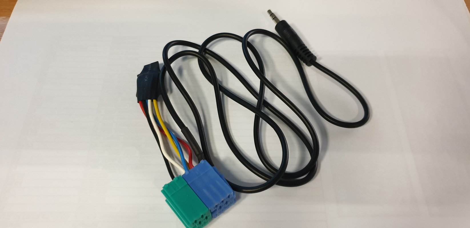

This simple device act as CD changer so the head unit will enable audio input for CD changer. You can then play music from your mp3 player, or mobile phone on your stock head unit. I do not write any…
Read More…This simple device act as CD changer so the head unit will enable audio input for CD changer. You can then play music from your mp3 player, or mobile phone on your stock head unit.
I do not write any SW part of this but I do make some additions/fixes to code (check my GitHub repository). I only design PCB for my self and here you can buy it. After while I added more options which you can select, mainly assembled unit, kit or only boards. Based on the head unit you have installed in car and presence of connector in car, please select appropriate connector or cables termination: only pins (for mini-iso or OEM 12pin connector) or if you need also connector select appropriate one in the right menu. If you are not sure which connector your radio has, drop me a message and I try to investigate, but the best way is to take the head unit out and take a look.
Which connectore do you need? check your unit or look at the end of this page, there is list of supported units with information about connector used. If it's not there or connector type is not mentioned, drop me message
KIT:
PCB, preprogrammed PIC mcu, 5V regulator, pasives, 5x pins, no cables
assambled THT kit for refrence:
THT mini-iso kit:
THT 12pin connector kit:
for more detail about product read this archive of original wcdpic project: https://web.archive.org/web/20110817024153/http://www.k9spud.com/vwcdpic/
how to connect this emulator: http://kovo-blog.blogspot.sk/2016/11/how-to-connect-vwcdpic-adapter.html https://github.com/tomaskovacik/vwcdpic/blob/master/hw/pics/how-to-connect_audi.png
in case you or I messed something up, here is easy guide how to unpin everything in case of mini-iso connector: http://kovo-blog.blogspot.sk/2016/11/how-to-unpin-miniiso-connector.html
if you ordered SMD kit, here is assembly plan for it and here is assembly plan for THT kit.
