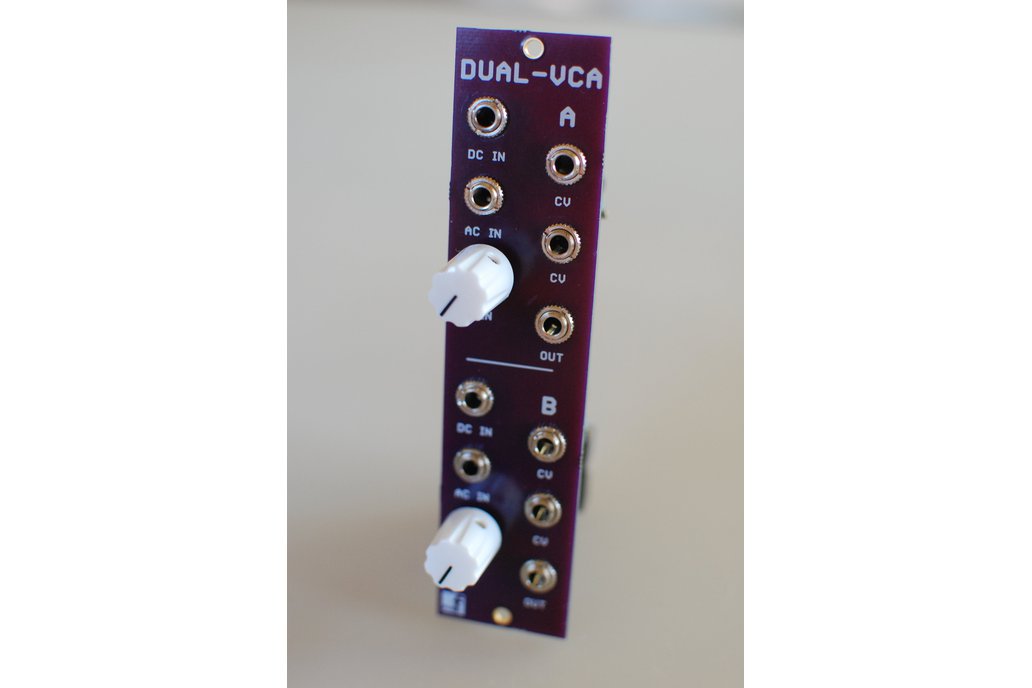

This module has two VCAs in a 6HP space for modular synthesizers.
All front panels are now black with white legend.
The CV will in general be driven by an ADSR curve generated during the time that a GATE signal is applied. The second CV jack can be used by another source to control the gain of the VCA.
The Gain pot is used to set the initial Gain when the CV is 0. The cut-off point of the VCA can be customized to suit a particular envelope generator.
There are DC and AC coupled inputs. The AC coupled input can be used to remove the DC part of an audio signal. The DC and AC jacks are exclusive-OR switched together with the DC jack having override priority.
This is a low component count project so you can have high quality VCAs in your rack with minimum expense.
Build it yourself - FOR INTERMEDIATE SKILLED CONSTRUCTORS - This is a high quality PCB and front panel ONLY for users who want to purchase their own components and build their own module. Some product photos above show COMPLETED build.
This module will fit perfectly into a 6HP Eurorack space.
