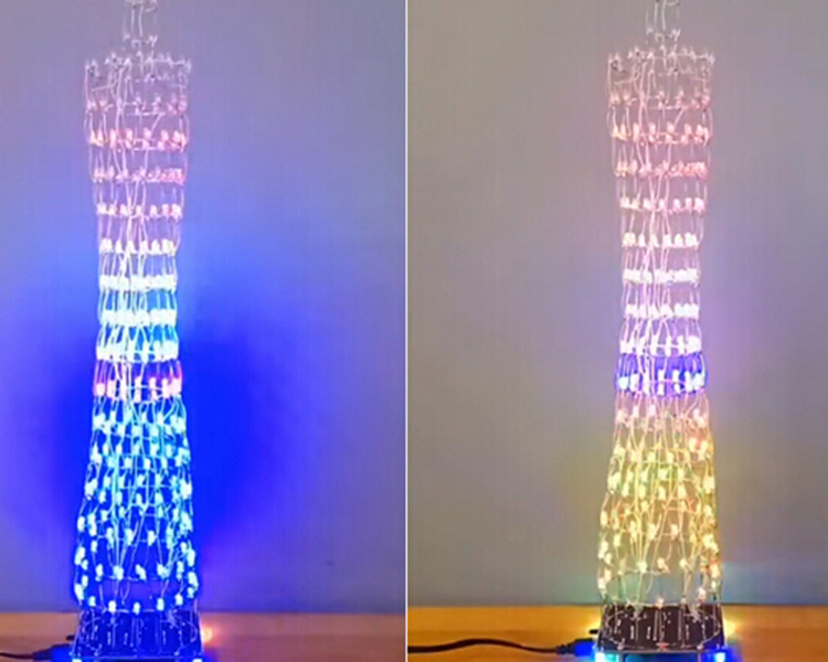

LED Tower is imitated from Guangzhou Tower. Guangzhou Tower, also known as Guangzhou new TV tower, nickname Xiaoman Yao. It is the tallest building in Guangzhou, the design of the tower is very characteristic, especially in the night under the lighting decoration, it is beautiful. We use STC12C5A60S2 as a control system, the display part is 16*16 dot matrix display, through the production of the Guangzhou Tower, can better enhance the microcontroller on the principle of dot matrix display.

Finished Product Picture(for reference)
