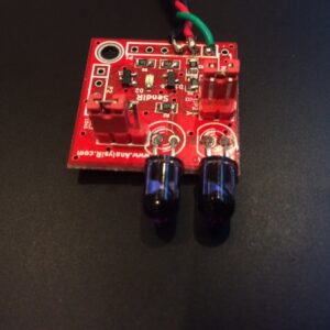

SendIR is an advanced module for sending modulated Infrared signals using a microcontroller, with dual LEDs,constant current driver and more

Overview SendIR – is one of the most advanced IR emitter modules available for sending remote control modulated Infrared signals using a microcontroller. SendIR allows makers, hobbyists and profess…
Read More…SendIR – is one of the most advanced IR emitter modules available for sending remote control modulated Infrared signals using a microcontroller. SendIR allows makers, hobbyists and professionals to send infrared signals from their microcontroller projects using quality IR components and excellent design features. SendIR is a drop in replacement for any IR emitter circuit and provides excellent range and signal quality for both 3V3 and 5V systems. It can be powered directly from the microcontroller supply, batteries or via an independent DC power supply. SendIR outputs high quality IR signals, thus ensuring optimum performance, reliability and range every time.

SendIR is an excellent companion device for any 5V or 3V3 project and can operate from 2V5 to 5V supplies. It can be configured with single or dual emitters for more demanding projects. Single emitter mode is recommended for 3V3 supply or below, unless dual aspect coverage is the primary requirement.
SendIR advanced IR Emitter Module
Each SendIR module is configured with single or dual emitters plus a set of header pins and power selection jumpers (pre-soldered by default). You can opt to have the emitters and header pins soldered or not. Test points and spare positions are not populated.
IR range can be increased further by installing a programming resistor on the PCB. This is a feature of all of our constant current IR emitter designs in the MakeIR Kit series.
A quick-start guide is provided after purchase which covers: input headers, power selector jumper settings, 5v/3V3 operating modes, programmable resistor for custom power levels and Test Points for better understanding of the circuit and trouble shooting. IR range can be increased further by installing a programming resistor on the PCB. This is a feature of all of our constant current IR emitter designs in the MakeIR kit series.
