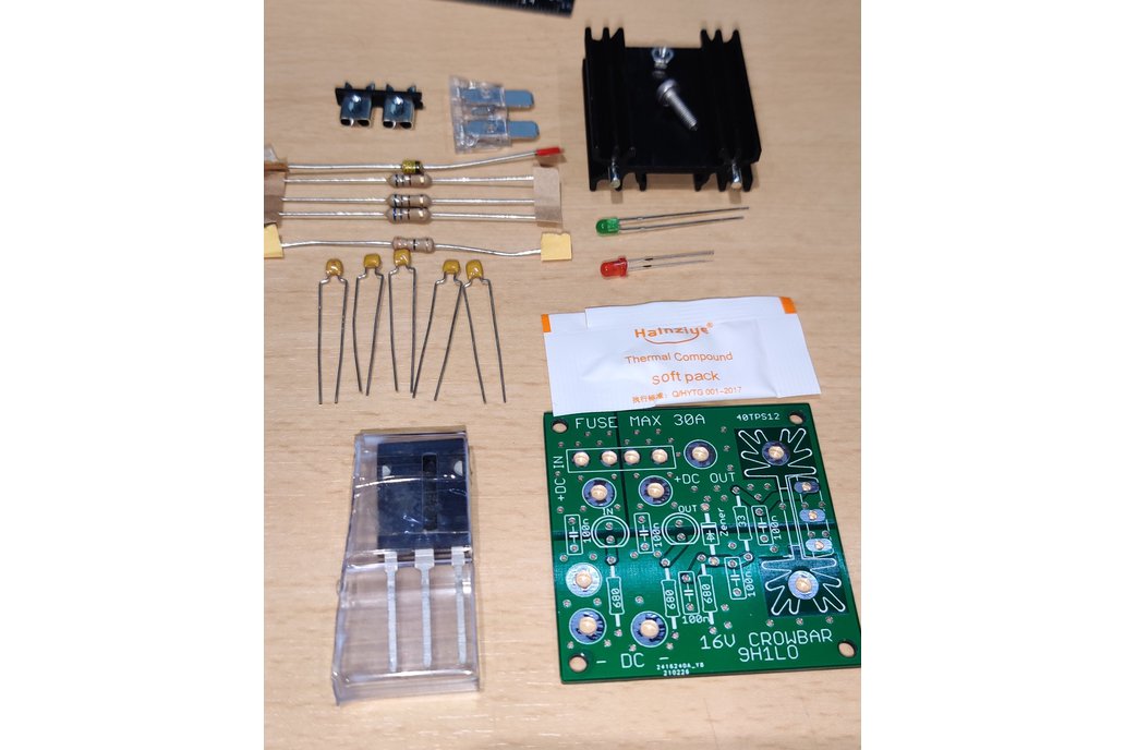

Most linear power supplies do not include a crowbar as over-voltage protection. Should the output pass transistors fail you risk your radio getting over 24V directly from the power supplies rectifier.
This circuit uses a 40TPS12 from Vishay which when triggered by the Zener diode will clamp the power supply to ground and blow the fuse, protecting your expensive radio from over-voltage.
This is available as a kit and supplied with the fuse size of your choice, as standard, a 25amp fuse is supplied, ask for a different value if you want and I will try to accommodate.
As standard the kit will clamp at around 18v +/- 1v, other voltages can be made available on request.
If you choose the ready-built & tested option: You can contact me to "tune" the values as close as possible to your wanted clamping voltage, this will be around +/- 0.5v though. If you wish I will apply conformal coating to the board FOC, but please request it if you want it, soldering to the terminals is still easy with a decent iron.
NO COMPROMISE ON PARTS QUALITY as this has to WORK 100% to save your radio, therefore all components are supplied from Farnell not cheap stuff from the far-east.
